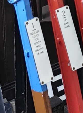

Maybe our Witham Bobby can answer but what does lever 1 unlock/release?
Re: Where was JayMac today, 30th October 2024?
Posted by JayMac at 11:43, 31st October 2024
Posted by Witham Bobby at 13:11, 31st October 2024
Well, it used to be the Up Distant Signal on the end of that one.  The GW usually used "fixed distant" signals at passing places on single lines.  As in fixed at "caution" in order to remind drivers of the speed restriction entering the loop.  This would perhaps be 15 or 20mph.  When the Minehead Branch was upgraded in the 1930s, the pointwork at each end of the loops was laid-out for 40mph running, and automatic token exchange apparatus was installed.  So fast trains could rocket past places like Williton and Blue Anchor without having to loose much speed and time.  So, workable distant signals were installed.  If the section ahead was clear, and the token had been obtained, the signalman could load up the auto exchanger with the token and clear the signals, including the distant, and later watch the train clatter past.
When we came to re-open the line, we took the decision (encouraged by the Railways Inspectorate) to use only fixed distant signals.  With a 25mph line speed limit (or 40mph for DMUs) there would be no time saving by having these signals workable
Now, as the picture shows, the lever is a release, for the ground frame that gives access off the Down Loop into the yard.  The shunter needing to make a move into or out of the yard will call-up the bobby and ask for a release, which enables the ground frame to be used at the location, to shift the points.  Once the release lever in the 'box is reversed, all the levers for the running signals that could lead to conflicting moves will be locked normal, so that the signals can't be cleared.
I don't know the exact setup at Williton for this, but it's usual for the signaller reversing the release lever resulting in a key in normally locked an instrument at the ground frame to becoming released.  The key can then be inserted in a lock on the ground frame to enable its levers to be operated.  When the shunting operations are complete and the running line is again clear, and the levers in the ground frame have been set back to their usual positions, the key can be removed from the lock and put back into the instrument, the signaller advised, following which the release lever in the 'box can be restored to normal, and the running signal levers are then freed to be operated.
You'll note that the top of the lever has been cut off.  The lever is in effect a switch, needing not much effort to work.  You wouldn't want to put your weight behind it and give a big swing.  The shortness of the lever is a reminder.  Helpful in not ending up on your a*se
